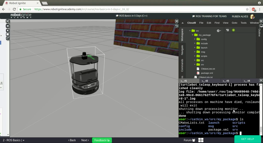

We’ll go to the ROS in 5 Days(C++) course today. Let’s go to 2nd part-ROS Basics and start by creating a package
cd ~/catkin_ws/src
catkin_create_pkg my_package rospy
With the command, ROS will create a package with the CMakeLists.txt and package.xml files automatically for compiling and building. The package is the basic building block for ROS project. Basically, every ROS application is built with packages. Take the following command as an example
roslaunch turtlebot_teleop keyboard_teleop.launch
Where the turtlebot_teleop is a ROS package and keyboard_teleop.launch is a launch file in this package.
In the RIA, all the packages you’ll need is already installed for you. The only thing you need to do is focus on learning ROS!

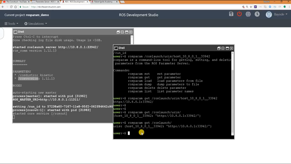

Great, now I got away with my fingers intact, and here we have a list of all current ROS parameters, including the ones mentioned earlier in the roscore command output. Next, let’s explore another sub-command of rosparam: get.
user:~$ rosparam get /roslaunch/uris/host_instance__45696
http://instance:45696/
{host_instance__45696: 'http://instance:45696/'}
uris: {host_instance__45696: 'http://instance:45696/'}
I decided to get one of the params from the list command that demonstrates that ROS parameters can be stored and retrieved in hierarchies, to store related parameters and to prevent parameter names from colliding.

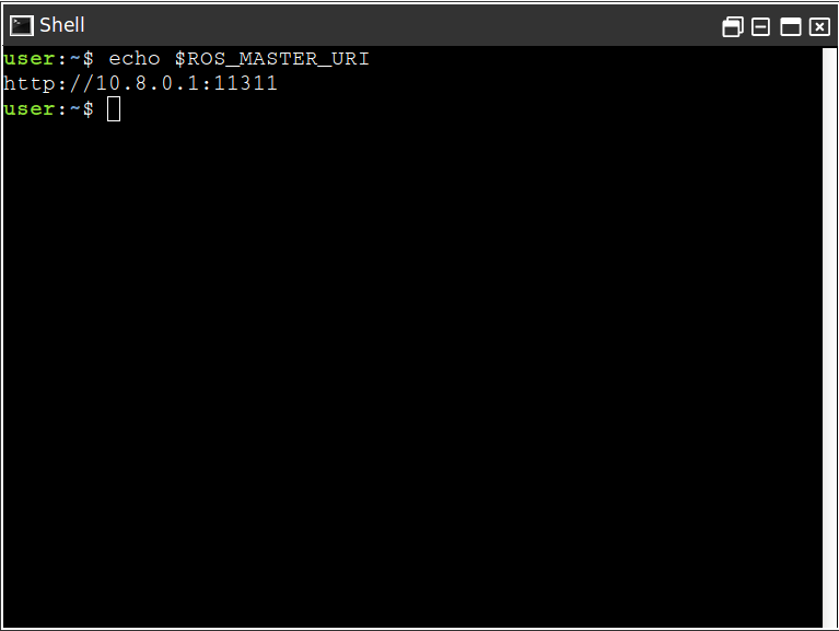

  • Open Tools > Shell and run following commands

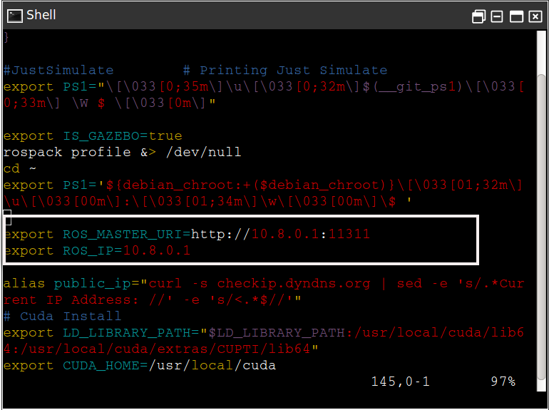

$ echo $ROS_MASTER_URI
Note the result of the above command, it should have the following format http://<ip>:<port>. The following image shows a representational value
The specific values shown in the image are \<ip>=10.8.0.1 and \<port>=11311.

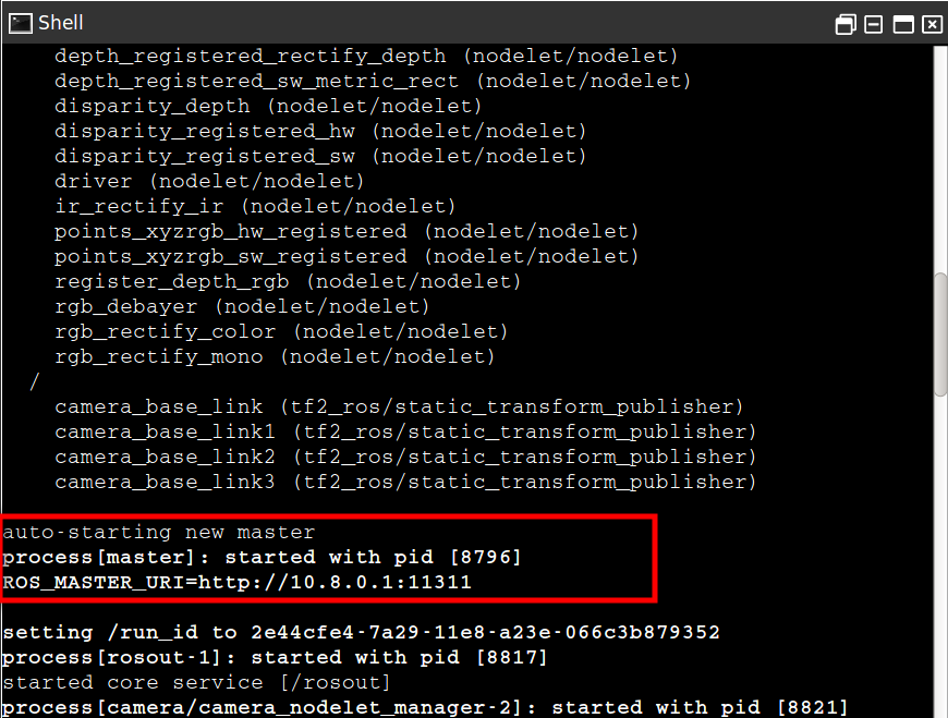

$ roslaunch openni_launch openni.launch
When the above command executes, it will launch the openni project. First of all ros master will be run (as shown) and once the ros master is ready other nodes are loaded. Note that there is only one ros master, however any number of nodes can exist.

Next we can see how to change the ROS_MASTER_URI. The simplest way to change ROS_MASTER_URI is by editing the .bashrc file. This file is a system file and thus hidden by default, we will modify its content using the vi editor. Use the following command to start editing the .bashrc file (located in home directory)
$ vim ~/.bashrc
The following line is responsible for assigning the ros master ip
export ROS_MASTER_URI=http://10.8.0.1:11311
We can modify this line to use any other ip address. For reflecting the changed ip we will need to load this bash file. Use the following command to do so
$ source ~/.bashrc
Once we have sourced the bashrc file, we will see the changed ros master uri when launching ros project.
