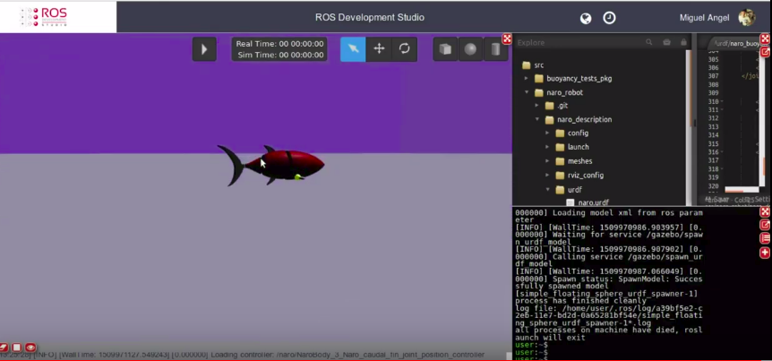

Launching a complex robot
In the previous post, we learned the basics of buoyancy plugin in the gazebo simulator using a floating sphere.
Now we are going to dive deeper into how to calculate the buoyancy for a more complex robot like a simulated fish. For that, we launch the main_submarines.launch located in the buoyancy_tests_pkg package mentioned in the previous post. If you launched correctly, you should have a simulation like the one below:
fish with buoyancy in ROSDS
The geometric buoyancy version of the fish is the one in the naro_geometric_buoyancy.urdf.sdf file, which has the following content:
