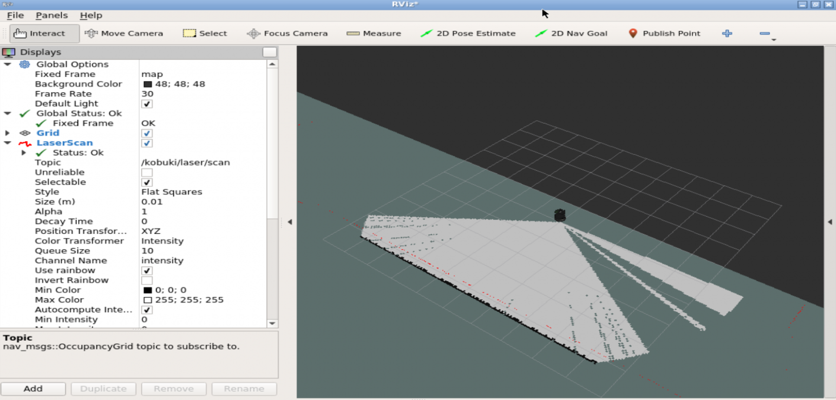

  • We will need a RVIZ windown to see the map visualization. Open a graphical interface window (see image)
  • Enter the following command in another SHELL to start the RVIZ visualization
    $ rosrun rviz rviz
The above command will load the RVIZ in the graphical interface window as shown. We will add displays to the RVIZ window (as shown in image)
  • RobotModel
  • LaserScan
  • Map
  • Make the following settings
    • Map : set Topic to /map
    • Laser : set Topic to /kobuki/laser/scan
Once the above settings are made, you should start to see the visualization in the RVIZ window

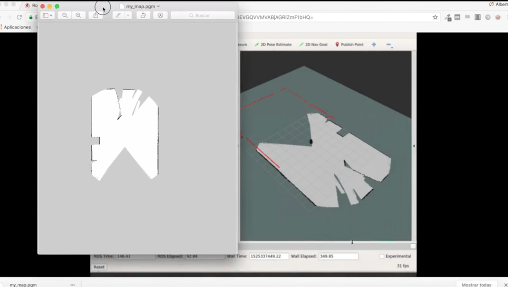

  • To save the current map, execute the following command in a new SHELL
$ cd ~catkin_ws/src $ mkdir maps $ cd maps $ rosrun map_server map_saver -f my_map $ ls
You should see two new files created inside the ~/catkin_ws/src/maps directory
  • my_map.pgm
  • my_map.yaml
Now we can load this map to the map_server with the following command
$ rosrun map_server map_server my_map.yaml

To test everythin works well we can run this launch file. Close the running instance of RVIZ and in the same SHELL use the following commands
$ roslaunch provide_map provide_map.launch
You should see the RVIZ window load with map. With this we finish this part.
