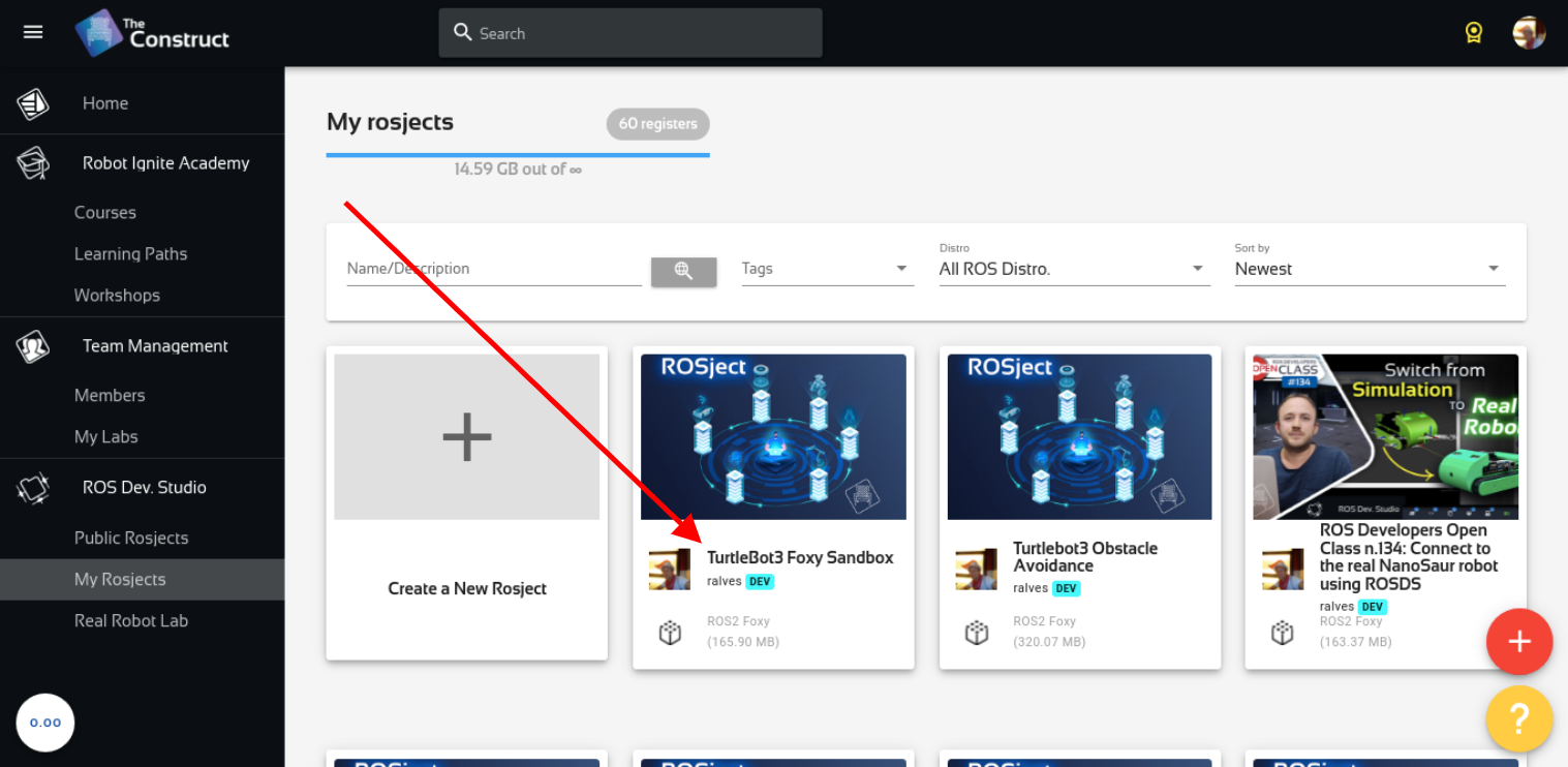

Once inside, let’s create My Rosjects and then, Create a new rosject:
For the rosject, let’s select ROS2 Foxy for the ROS Distro, let’s name the rosject as Turtlebot3 Foxy Sandbox. You can leave the rosject public.
If you mouse over the recently created rosject, you should see a Run button. Just click that button to launch the rosject.

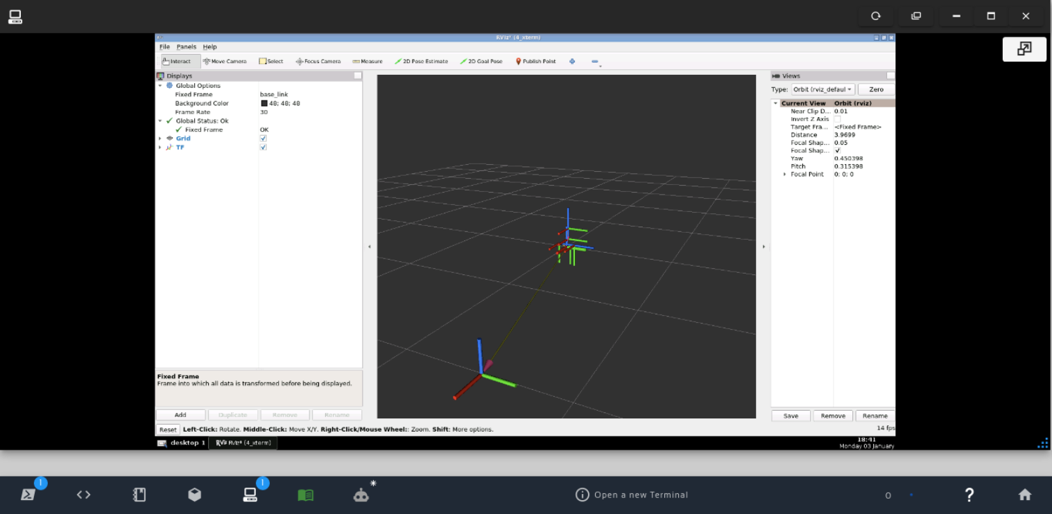

Now, in order to see the rviz window, we have to open the Graphical Tools:
If we now look at the left side of the rviz window, we can see a red error message saying:
Frame [map] does not exist
Let’s change that fixed frame from map to base_link to get rid of this error message:
After having selected base_link for the Fixed Frame, let’s now click the Add button available on the bottom left corner of rviz, and select TF.
After adding TF, we should see the transforms in RViz.
The group with more frames is the robot, and the one with fewer frames is the odometry.

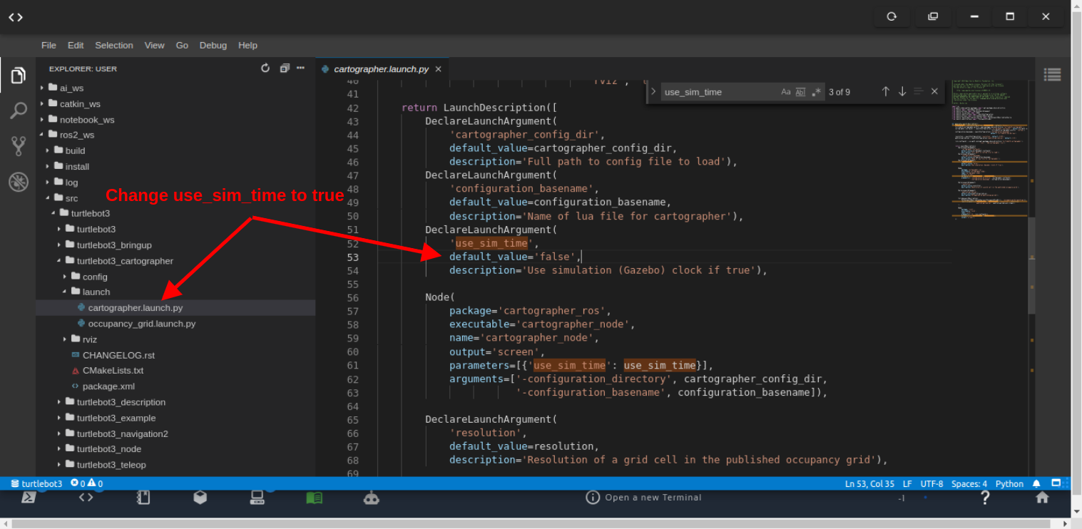

We need to launch the cartographer node to get the map frame published, but before that, let’s change the ~/ros2_ws/src/turtlebot3/turtlebot3_cartographer/launch/cartographer.launch.py (around line 53) and set use_sim_time to true. It is false by default because the code is ready for the real robot, but since we are using simulation, we have to change the variable.

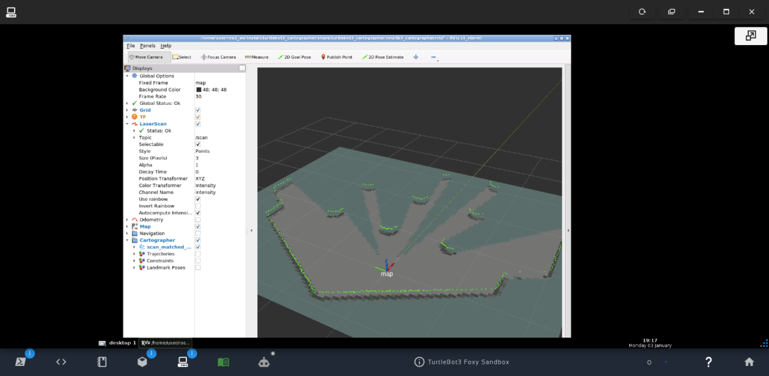

If we now open the graphical tools again, we should see a nice rviz2 configuration, and the map as the fixed frame now works:
The cartographer node is the one publishing the tf for the map.

If you check the graphical tools again, you should see a more accurate map.

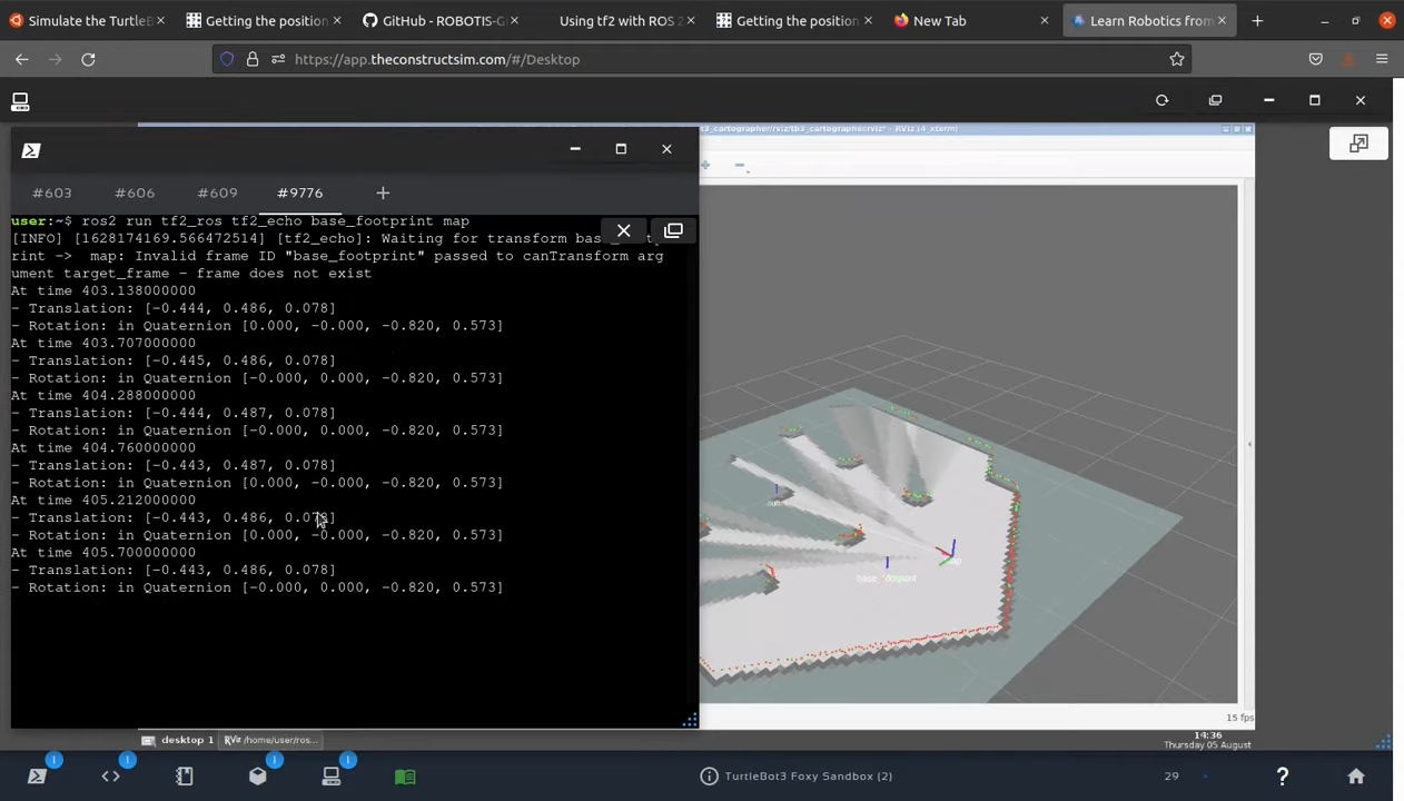

Getting the position of Turtlebot3 using transforms
We are almost there. We have already compiled the simulation, launched it, and launched the cartographer node.
Now, in order to get the position, we just need to do an echo between the frames to figure out the position.
Let’s echo the frames with the following commands in a fourth terminal:
ros2 run tf2_ros tf2_echo base_footprint map
If everything went well, you should now see the position of the robot on the map:
