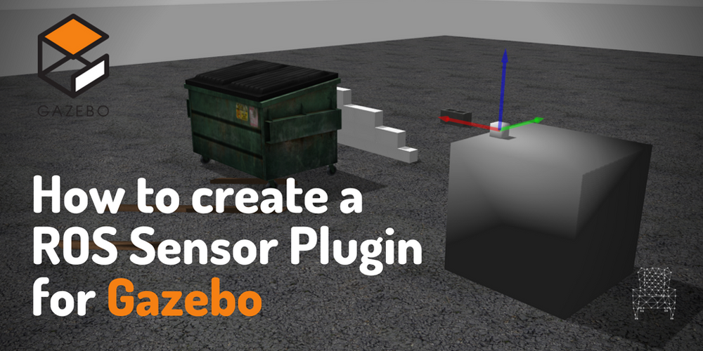

How to create a ROS Sensor Plugin for Gazebo
There are magnificent tutorials about how to create plugins for Gazebo in the GazeboSim webpage. There are even some tutorials about how to create plugins for Gazebo + ROS. Those tutorials show that there are several types of plugins (world, model, sensor, system, visual), and indicate how to create a plugin for a world type plugin.
Recently I need to create a plugin for a light detector. Reading the tutorials, I missed a concrete example about how to create a sensor plugin. Hence, I had to investigate a little bit about it. The result is the content of this post.
How to: light sensor plugin in Gazebo
Following the indications provided at the answers forum of Gazebo, I decided to build a very simple light detector sensor based on a camera. Instead of using a raytracing algorithm from lights, the idea is to use a camera to capture an image, then use the image to calculate the illuminance of the image, and then publish that illuminance value through a ROS topic.
Since the plugin is for its use with ROS, the whole plugin should be compilable using a ROS environment. Hence, be sure that you have installed the following packages in your Linux system:
  • ros-<your_ros_version>-<your_gazebo_version>-ros. (in my case it is ros-jade-gazebo6-ros)
  • ros-<your_ros_version>-<your_gazebo_version>-plugins (in my case it is ros-jade-gazebo6-plugins)
This tutorial, has two parts: on the first one we will explain how to create the plugin, and on the second, how to test that it works
