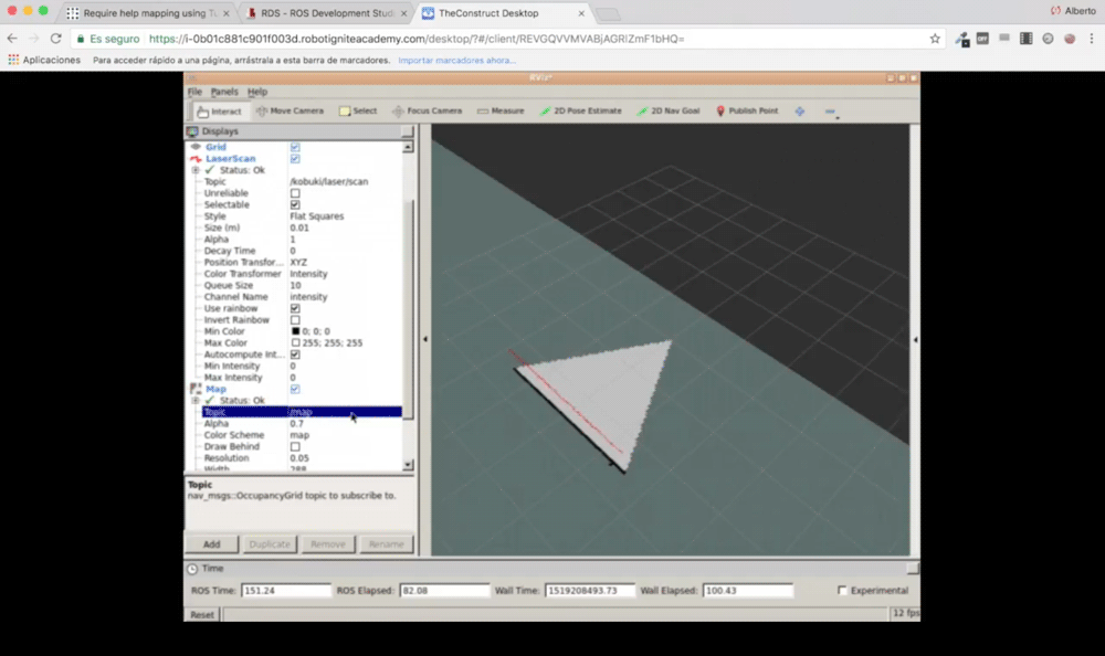

Let’s check it further with Rviz by typing.
$ rosrun rviz rviz
1.In order to see Rviz running in the RDS, open the Graphical Tools in the Tools Tab.
2.Add a LaserScan visualization.
3. The visualization is not showing due to some problems with the frame.
4. Let’s change the fixed frame to the fake_laser_frame
Now everything looks fine but the laserscan still not showing.
How come?
It turns out, in this particular example, it’s not showing simply because the size of the visualization is too small to be seen. Let’s change the size.
Takeaway Today:
- You can check if one topic is publishing correctly by typing rostopic echo /TOPICNAME
- If you want to check the topic in RViz, remember to select correct topic type, correct frame and choose a proper size!
